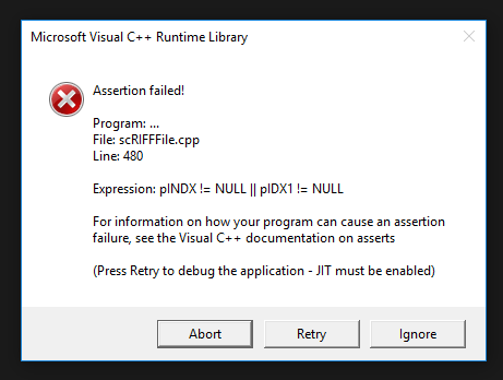

    Anyone know this filetype?
    From a consumer camera (or have they 'edited' it with VLC???): vlc-record-2017-01-25-16h10m36s-AA010701.MXF-.avi
    It totally crashes Avid with a nasty 'assertion failed' system error on an AMA link or straight import.
    Sorenson spits it out too.
    Plays lovely with VLC!!!
    What is this demon?

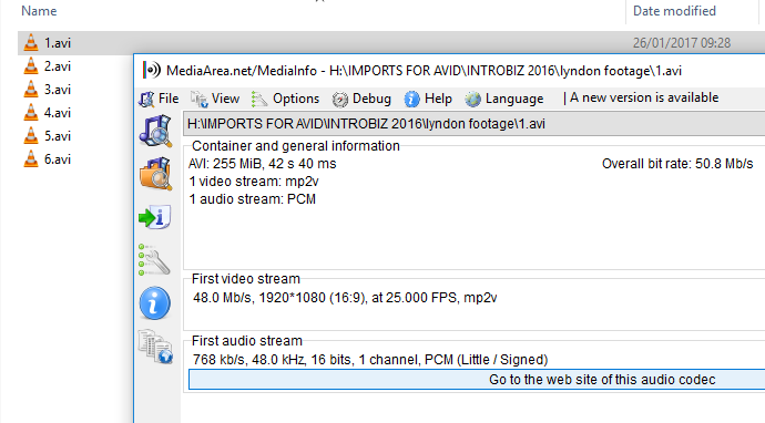

    Good shout Carl but renaming file to just 'clip 1' and tryin an AMA still brings the walls tumblin' down:
    This is the actual file type details:

    Re: Anyone know this filetype?
    Oh, that's an MPEG, not going to work with MC
    You can try to convert this with handbrake(i hope it works there)
